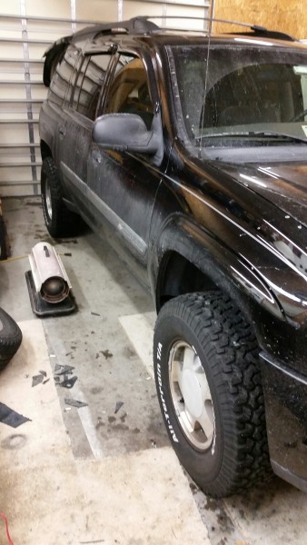

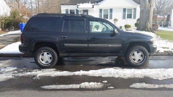

Hey everyone just wanted to share a quick photo of my TB on 33"s. The wheels are 16" wheels from a 96 silverado and the tires are 33x10.50 BFG all terrains.

by kcb58h » Tue Mar 03, 2015 10:51 am
What the heck kinda picture is that? Don't tease me! I'm encouraged by what I can "almost" see in it. Back that land yacht out into the cold so you can take a side pic. I'm dying to put 275/70s on my 18", yes, 18" A/R wheels (33.2") using only Mark's 3" spacers and 87s (already purchased and sitting in my house) without a body lift. All I saw mentioned in your posts was a 3" (suspension?) lift. Did you stay with stock coils? The stock 83s on my 04 2wd EXT and a 2" R/C levelling kit fit my current 31.6 BFG A/Ts with acceptable but not comfortable clearance. I'm saying all this because I don't think I can do 33.2 even with 89 springs, so I can't wait for more pics of yours.

by jmar07 » Tue Mar 03, 2015 12:38 pm
Hahaha I will have more pictures very soon and be doing a build thread. Currently on the TB is there 3" lift as well as marks 1.5 wheel adapters. Also had to do some inner fender trimming but nothing to serious. The hard part was in order for me to clear the 16" wheels on the ext I had to go to a local pick n pull and take the front brake system off of a envoy. However I am very happy with the look everyone at work has been complementing it as well which is always nice.

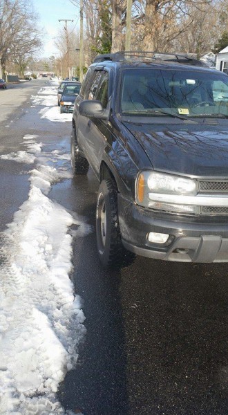

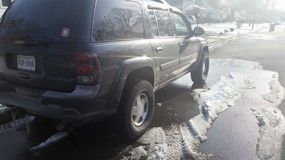

by jmar07 » Tue Mar 03, 2015 3:31 pm
:flex dirty: Here some Pictures just to make you feel better KCB58h

by TBYODA » Tue Mar 03, 2015 3:44 pm
Nice, hope you have 3.73 or bigger gears.
by jmar07 » Tue Mar 03, 2015 4:53 pm
4:10

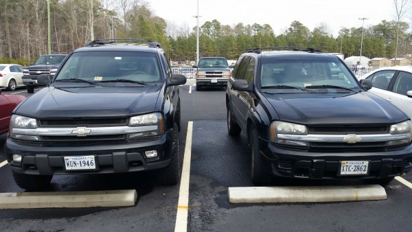

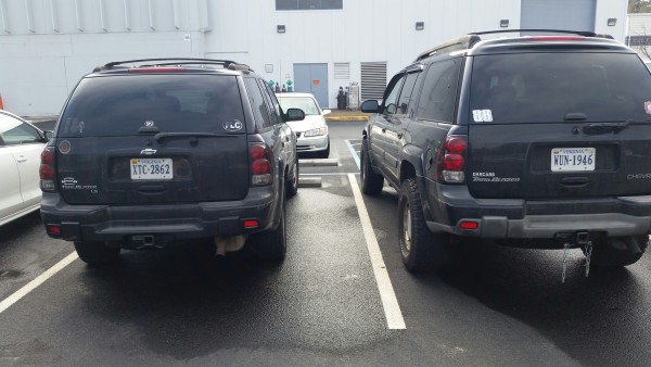

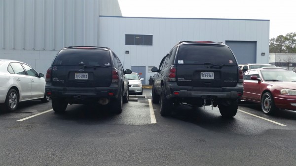

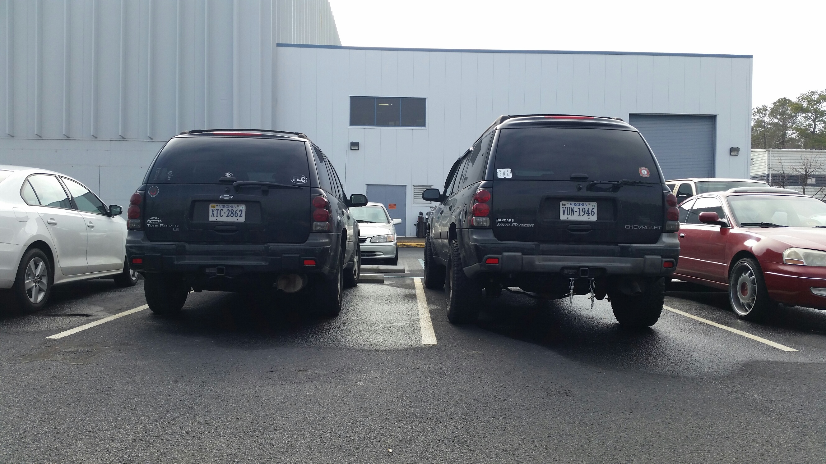

by jmar07 » Wed Mar 04, 2015 4:02 pm

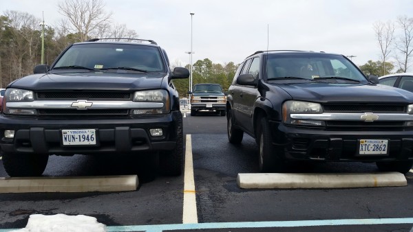

So I got the chance to park next to a stock TB today at work.....Of course I couldnt resist pictures haha had to share!
jmar07
Posts: 25
Joined: Fri Feb 20, 2015 11:43 am
by Jrgunn5150 » Wed Mar 04, 2015 4:11 pm
That's pretty drastic, I wonder if the other guy noticed at all
by jmar07 » Wed Mar 04, 2015 4:39 pm
Haha im not sure he is still here so im guessing not yet. Im quite happy with the difference though!

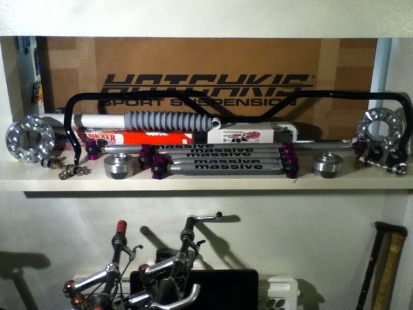

by kcb58h » Sun Mar 08, 2015 2:16 am
Whew! What a relief. 33s and no body lift. Your TB looks oh-so-right! Great job. I'm putting Massive GMT-360 rearend on to center axle, (adding 2.75" lift to back), but yours looks correct. Really badass, man. Thanks for the pics.
