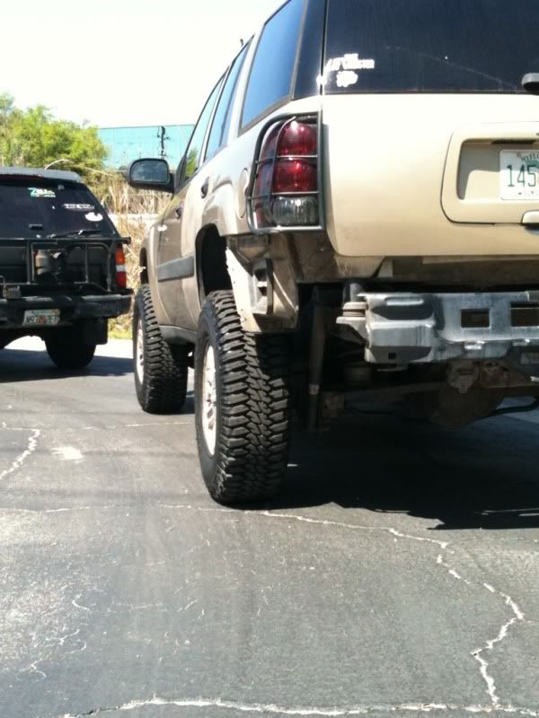

by Hpimichael02 » Mon Mar 28, 2011 12:38 pm
Lol Mario I did buy 4 tires cause they needed replacing cause they were bald , they were the only two pics I took

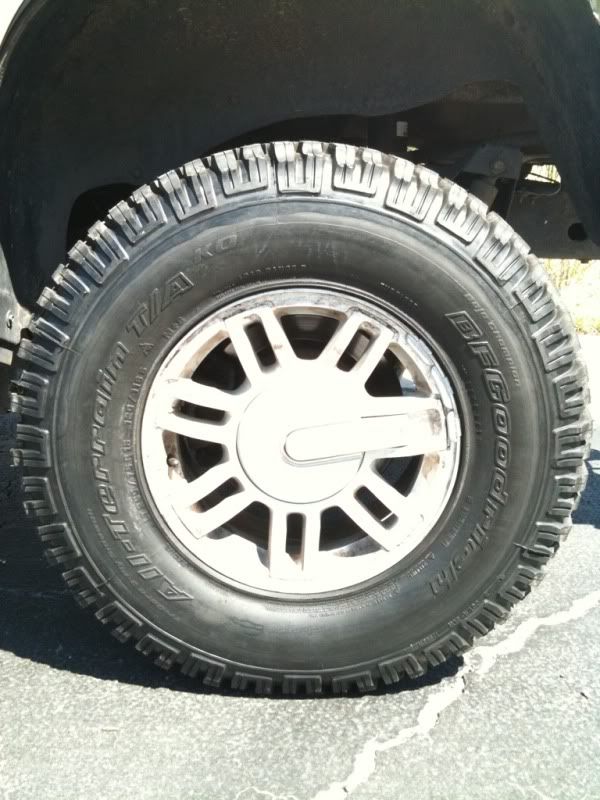

by Regulator1175 » Wed Apr 13, 2011 12:10 am
So a few weeks ago Kyle noticed some cracking on my Treadwrights. It was mainly on the spare, but some small places on a couple of the other tires. I got a couple pictures and mailed Treadwright last week. Here are the pics...
This afternoon I got a phone call from their shipping department telling me that they do not have a 4 ply BFG carcass, however they do have what I wanted in a 5 ply and asked if that would work. I of course said yes, and I have 5 new tires in route to me tomorrow.
Later this afternoon I got a mail from their warranty dept indicating "I am sorry to see that you have experienced this issue and I am going to have a replacement set of five sent to you. We believe this cracking is due to a shipment of rubber we received from a supplier whom we have stopped using due to it."
When I talked to them I asked what I needed to do with the old tires and I was told to just leave them on the truck until it was truly necessary to replace them. They said that the tires are still safe to drive on, and that I just need to keep an eye on the cracks and replace the tires when they start to increase on the road tires.
