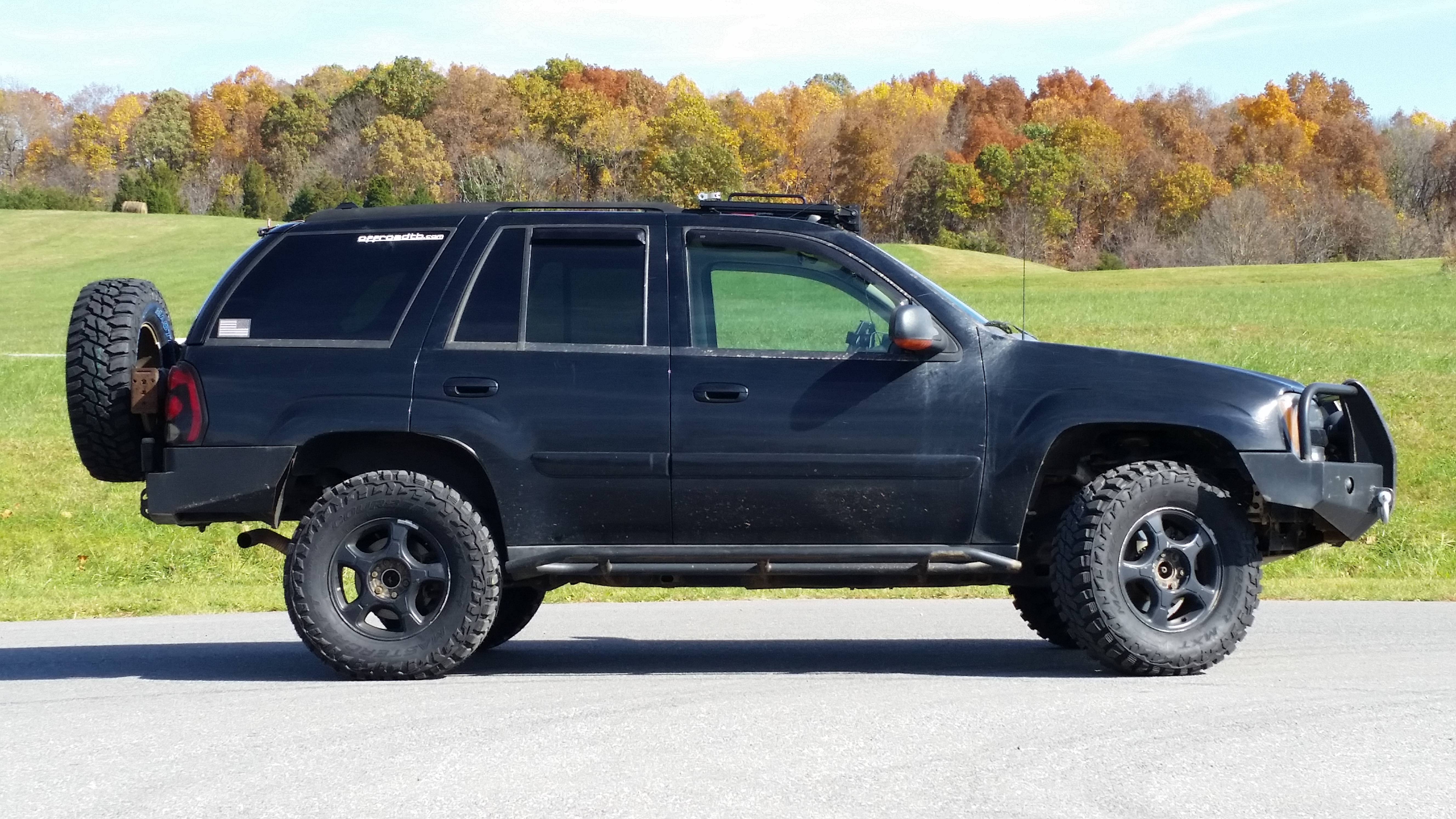

Well, the 285/70R17 fits without rubbing, lock to lock. Still no trimming needed with 33"ers.

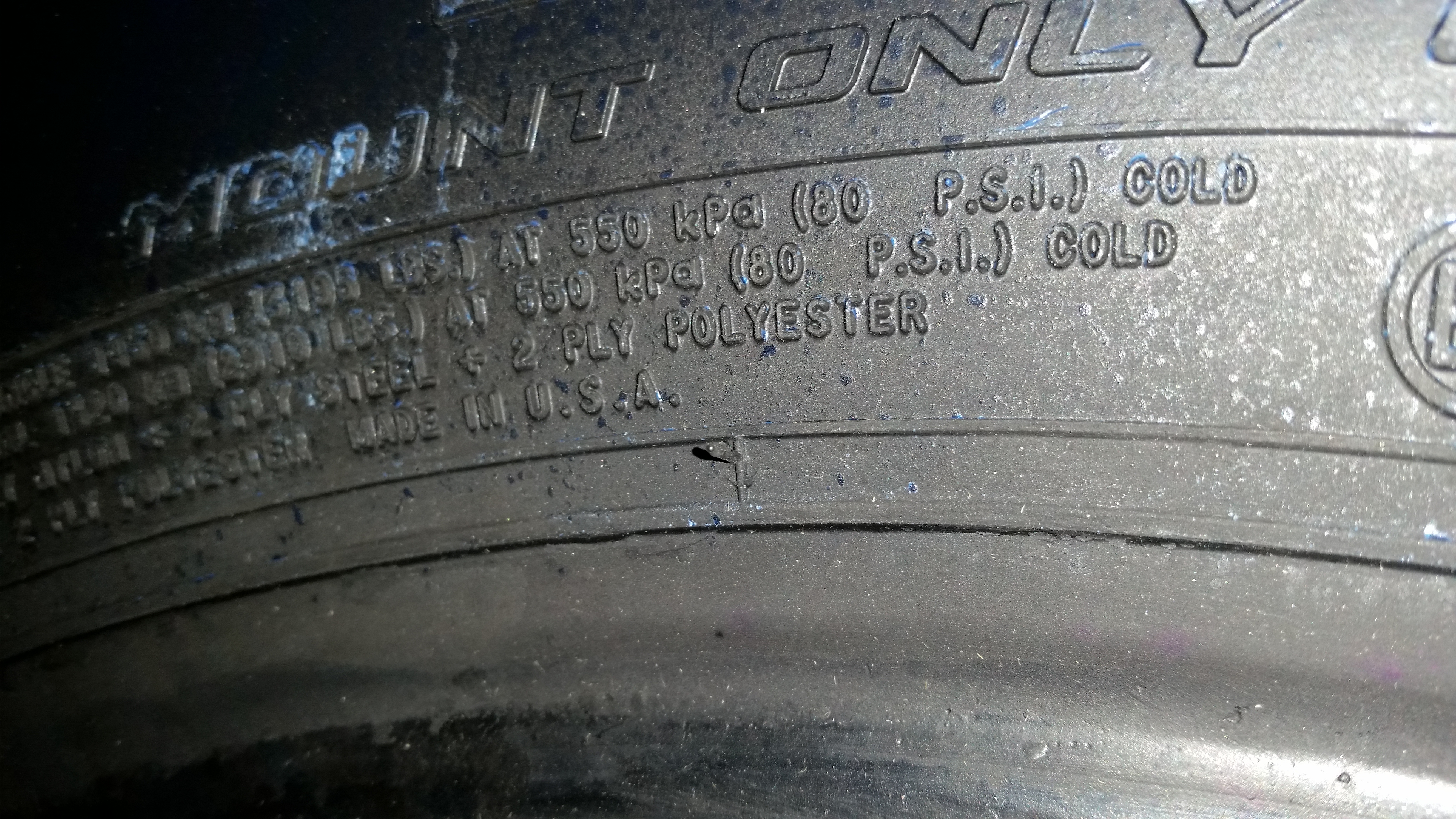

I also confirmed that the Mastercraft are made in USA (I had heard they were made by Cooper, but I hadn't confirmed they were, nor had I confirmed they were made in USA).
It took a good bit of weight to balance them, but they ride real smooth. I expected the E range tires to ride rough, but I really like them so far. They feel much more stable than the C range.
The only negative I've found so far is that the tires don't have the "bead protector" feature built into the sidewall, but its a minor gripe. I knew the tires didn't have that before buying.
by HARDTRAILZ » Tue Oct 28, 2014 1:14 pm
Look good. I am curious what PSI will work best with the E vs the C. My E pro comps wore perfect at fairly low 30ish psi because of the stouter construction.
by DirtyBacon04 » Tue Oct 28, 2014 2:26 pm
Lookin good James! Rig looks a lot better with the bigger tires.
by ErikSS » Tue Oct 28, 2014 2:27 pm
Truck looks good James. My tire pressure monitors kick off around 32psi. I run 34psi to keep them off but I would probably run 30psi if the light didn't bug me.

by TBYODA » Tue Oct 28, 2014 6:16 pm
Trail X wrote:Well, the 285/70R17 fits without rubbing, lock to lock. Still no trimming needed with 33"ers.
James I think you are on to something with pushing the LCA forward giving you + caster.
