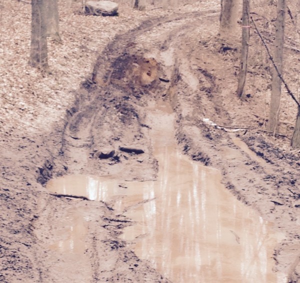

I agree with above , I'd also highly suggest the MDB radiator skid also, our radiator sits very low and you could hit it very easily on a trail.
Here a example from my last wheeling trip.
Do you see the pushed up dirt in the middle between the ruts, yep the rad skid did that, my TB would have been done here if didn't have a rad skid. In the end that hill was to rutted for my 32"tires :( but I did gave it a good old try, me and the side of the hill didn't get along. ;)
I'd also say wheel spaces and 32". That size is very doable with 3.42 gears with a aux tranny cooler for added Insurance.

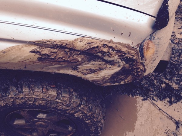

Be happy that is all you hit, the radiator could possibly be patched on a trail enough to get you out and really won't damage the motor if caught in time. Unlike a short lived member from Albany NY that that took his stock TB on some (illegal ) power line trails and punched a hole in the oil pan. Needless to say he had to be towed out. He replaced the oil pan and dumped his TB on some unsuspecting buyer. I am sure the motor was damaged some how.
This all could have been avoided if he would have done the research here on this site and saved and spend the cash. Instead he was in a rush to go hit the trails.
You also need to be ready for some other damage like I did above. I wasn't to upset because a fender is cheaper that door. I was about to pound it out pretty good. ;)
