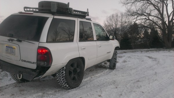

im curiouse to see how u guys mounted your high lifts. iv been thinking bout doing a hood mount, but the question is how. post some pics and feel free to explain how you did it :). the more ideas the better. i need to get mine off the rack, i keep hooking it on branches since its mounted on my roof rack.

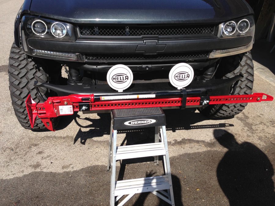

I just looked at your build thread. Dude get the tube mounts and run it off of your bar on your bumper.

Never had an issue with mine on the roof rack. Personally don't like the hood or front bumper mount, but would not mind figuring out a way to get it mounted to the rear bumper.
by The Roadie » Mon Dec 30, 2013 1:02 am
I had mine on the side of the roof rack until I spent 30 seconds analyzing the forces in a 5 mph collision at a stop light. It would turn into a lethal javelin.
Posts: 5011
by HARDTRAILZ » Mon Dec 30, 2013 1:16 am
Mine bolts through crossbars so the whole rack has to come off. Having seen the bar mounts for bumpers and hood mounts...my bolts are just as solid.

Blazintrails03 wrote:I just looked at your build thread. Dude get the tube mounts and run it off of your bar
I could but it's a really steep angle, don't think it would work.

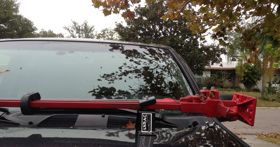

by mikekey » Mon Dec 30, 2013 11:42 am
I tried, those jeep mounts are taller than they look.
Not going to work, so you might as well throw that idea out unless you want to stare at it.

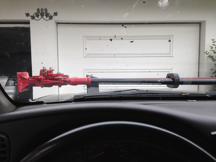

by Moots1288 » Mon Dec 30, 2013 11:46 am
There mounts are shorter then those but there body shape is allot different anyways
by tarsh » Mon Dec 30, 2013 11:49 am
Oooo man! I like it. I'd just make mine as lo profile as possible. Do u have any more pics of it?
Take the path less traveled
tarsh
Posts: 483
Location: MI, Holly
Name: Nathan Schroeder
by mikekey » Mon Dec 30, 2013 11:56 am
No additional photos, because I was experimenting. I tried a few different things in the past. Including mounting to the front bumper, which didn't look right either. Set it on your hood, even if you make it lower profile, and mount the base on the passenger side, you're still going to have a huge obstruction staring at you. Doubly so if you bought the cover for the base to protect it from the elements.
