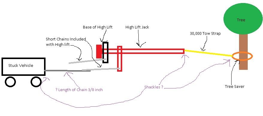

Last pieces include some chain to use with the highlift when winching as well as some Shackles.
What size / grade shackles do you think would be appropriate. Also what about the chain, the short chains that came with the high lift kit I picked up are 3/8 inch, I think I would need the same size links to allow the hooks on those chains to fit.
Thought I would go pick something up at the hardware store last night but the largest shackle they had was barely the size of my palm..... dont think that's going to cut it.
Incoming horrible Paint diagram (more for my reference than yours) shield your eyes! :lol:

by Trail X » Tue Jul 19, 2011 9:19 am
3/8" chain works, but I believe I went with high strength 5/16" and it also seems to work fine. I went with the smaller chain to try to save a bit of weight.
As for shackles, I think a solid shackle for a decent price is the ARB 3/4" D shackle. 4 3/4T or 10,472lb is the WLL 6X safety factor. There's another shackle called the Van Beest Green Pins that are known for being quite good. Nothing at the hardware store will have close to the strength of a proper recovery shackle.

One other thought. In your diagram, reverse the chain, tow rope, and hilift. Your tow rope is longer, so it makes sense to have that section towards the vehicle, so you're not working next to the moving object. Just gives you some safety room.

JamesDowning wrote:One other thought. In your diagram, reverse the chain, tow rope, and hilift. Your tow rope is longer, so it makes sense to have that section towards the vehicle, so you're not working next to the moving object. Just gives you some safety room.
Here's another quick tip. I have a few straps in my kit, and they are all basically different manufacturers. None of them have the same tags and labels, so it could be easy to confuse which strap is which. I marked all of mine with a sharpie with S (for static) or D (for dynamic) on both ends, and marked down the strength rating in lbs (some were supplied in KG, Tonnes, etc).
Good ideas. I am sure at some point I'll pick up a few more tow straps so I have spares. Thankfully at the moment its really almost impossible (even for me :) )to confuse the two I have. The dynamic snatch strap I have is, well, as best I can describe it a bungie cord.
http://www.4wheelparts.com/Winches-and- ... S%2fBCC120
And good point on flipping the setup I had in the diagram. Not sure why I was doing it that way think that was just the orientation a few of the demo video's I had watched.

by snowmirage » Thu Jul 21, 2011 6:22 pm
I stopped by the store to order a full size spare and to pickup a few of those shackles.
As I was walking up to checkout I realized there is NO WAY that 3/4" shackle is going to connect to the 3/8" chain (.... obviously guess I didnt think about it till I had it in my hand)
The shackles they had that looked like they might fit also didnt look strong enough, or maybe it was just because I had this 3/4" beast in my other hand.
The chain I have has heavy duty hooks on both ends, I guess the appropriate thing to do is just hook it to the vehicles tow point / recovery point right?
I liked the idea of shackles as there was no chance of something slipping and coming off, not that its likely to happen anyway.

by Trail X » Fri Jul 22, 2011 8:46 am
snowmirage wrote:As I was walking up to checkout I realized there is NO WAY that 3/4" shackle is going to connect to the 3/8" chain (.... obviously guess I didnt think about it till I had it in my hand)
Huh? You have grab hooks, right?
Your connection should be simple then. Take the grab hook - thread it through the eye of the shackle - grab back onto chain approx 1' from shackle creating a loop through the shackle.
by snowmirage » Fri Jul 22, 2011 10:58 am
:wallbash: Don't mind me been having brain farts all week. Ya that of course makes perfect sense.....
