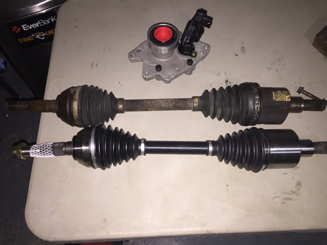

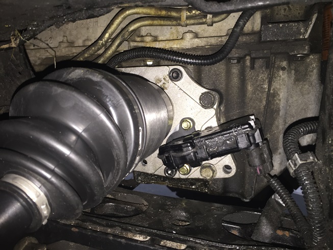

by bljis123 » Sat Nov 12, 2016 10:56 pm

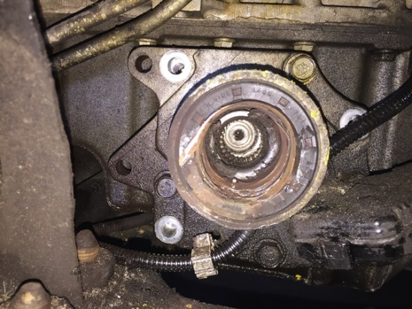

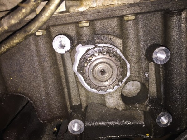

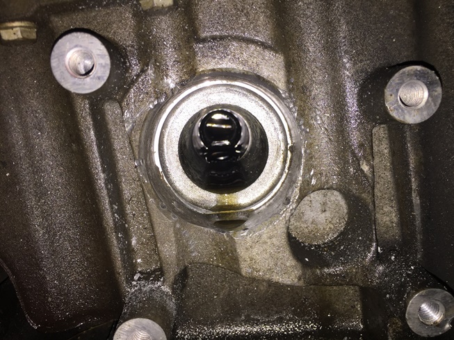

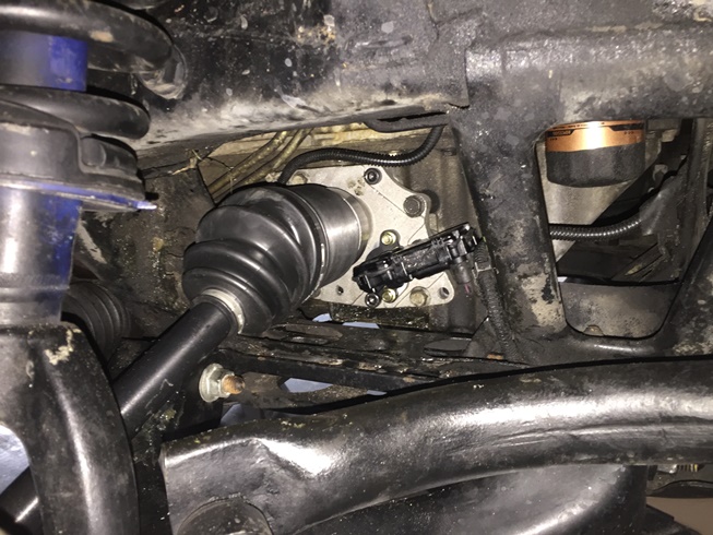

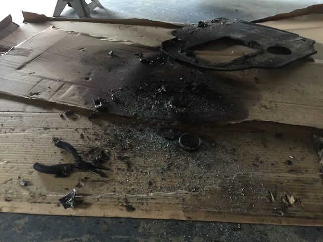

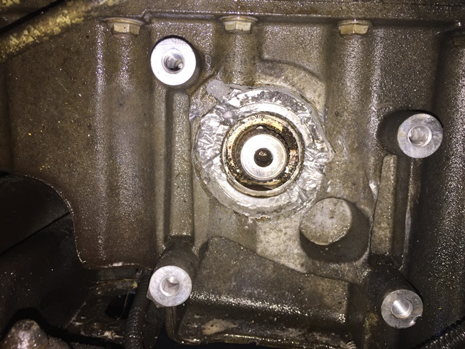

So my CV Axle was toast and fully extended, the inner joint locked and rolled over. This tore up the disconnect and lodge the back side bell housing to jam into the oil pan cavity. Let's get to the pics:
CV inner joint stuck at extension.
Lower part of disconnect shows axle rolled over
I beat the old Disconnect to get it off, it left the back bell housing lodged
Drilled holes and beat with chipping hammer for hours to break apart
It Cleaned up well thankfully
A rub mark on the intermediate shaft on inner side hmmm...
I could not get the intermediate shaft all the way into the disconnect, the bolts would start so I just backed it down in a star pattern until it was fully engaged.
2nd CV axle as I busted a whole trying to hit the tripod from boot side, thank you Auto Zone for warranty exchange!!

by HawkeyeC25 » Sun Nov 13, 2016 2:16 am
Great work and nice pics!!! I just ordered the AAM disconnect from Amazon an a Detroit Axle CV (mine had grooving from the outer bearing that had eventually failed).

by bljis123 » Mon Nov 14, 2016 12:53 am
Thanks Man!! That disconnect looks nice. I got the Duralast Gold CV and I am happy with fit and angle with lift. I took it out today for a minor test, armor coming soon.
