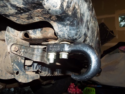

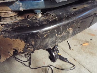

by TPuls » Fri Aug 22, 2014 9:11 pm
Replaced original back bolt that goes through impact bar and frame with ~1 1/2" longer bolt to accommodate tow hook. Then, I widened an existing hole on impact bar all the way trough the frame to drop in second bolt. Not shown here, but took cutting wheel and took roughly half inch square out of impact bar to fit a 19MM wrench inside to hold second bolt while I tighten nut on bottom.

by v7guy » Sat Aug 23, 2014 8:26 am
From the pics and description I'd be comfortable with that.
by Trail X » Mon Aug 25, 2014 1:10 pm
The only thing I'd try to do is get more washers on that frontal bolt. Tight bolts don't do much if they aren't squeezing down on something, but I'll agree with Jason, it's probably fine.

by TPuls » Tue Aug 26, 2014 8:11 pm
Yep, that's exactly what I did. I added another washer to the front one on each side so it was snug before I even started torqueing it down. I went back and forth whether to mount on top or on the bottom. But, I guess if I'm not happy it won't take much to switch them around.
Oh and these did not come with the retainer clips. This was really just a temporary mod so I had something for the next few trails runs we're doing this month. But, regardless, I still wanted to do it right. I'm hoping to have a new bumper put together after that.
