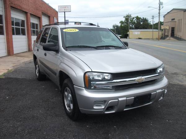

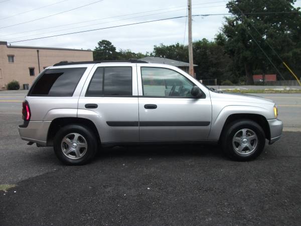

(100% stock) right before driving her off the lot

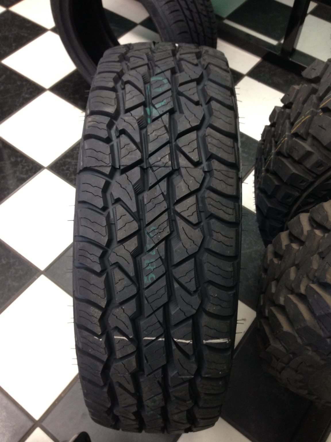

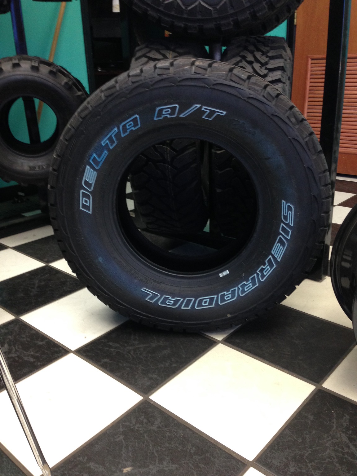

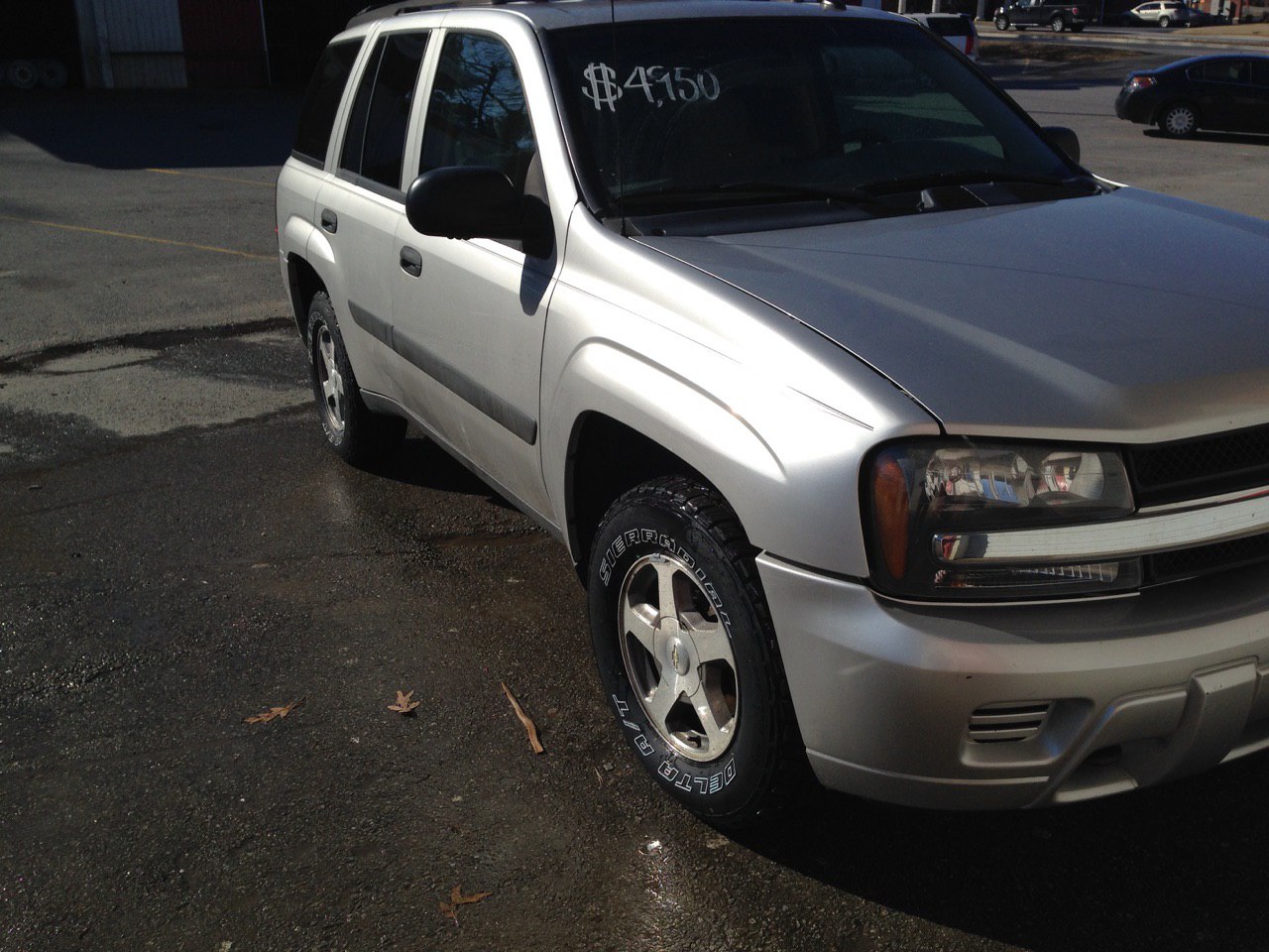

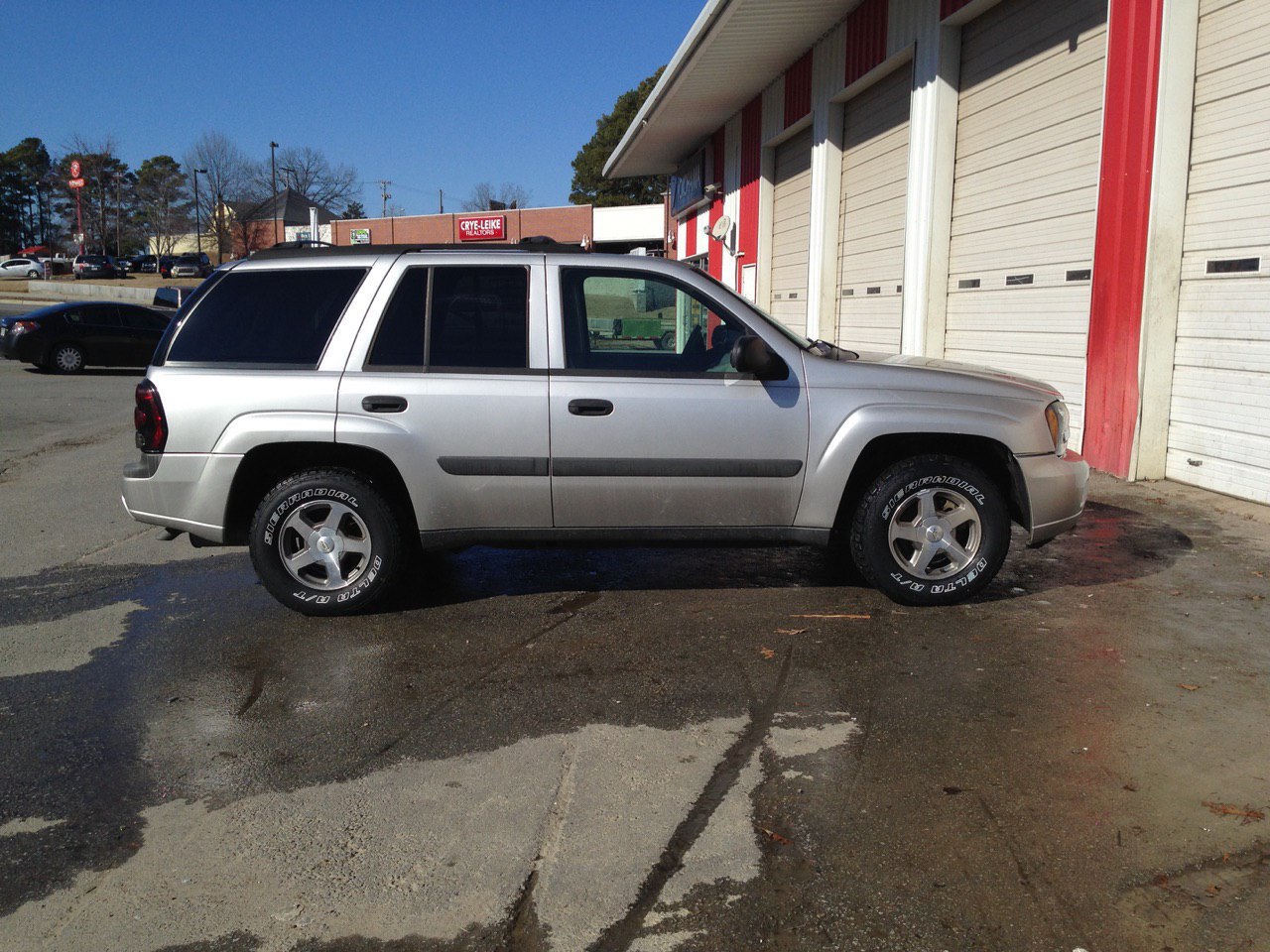

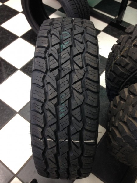

new Delta A/Ts on the way home from car lot

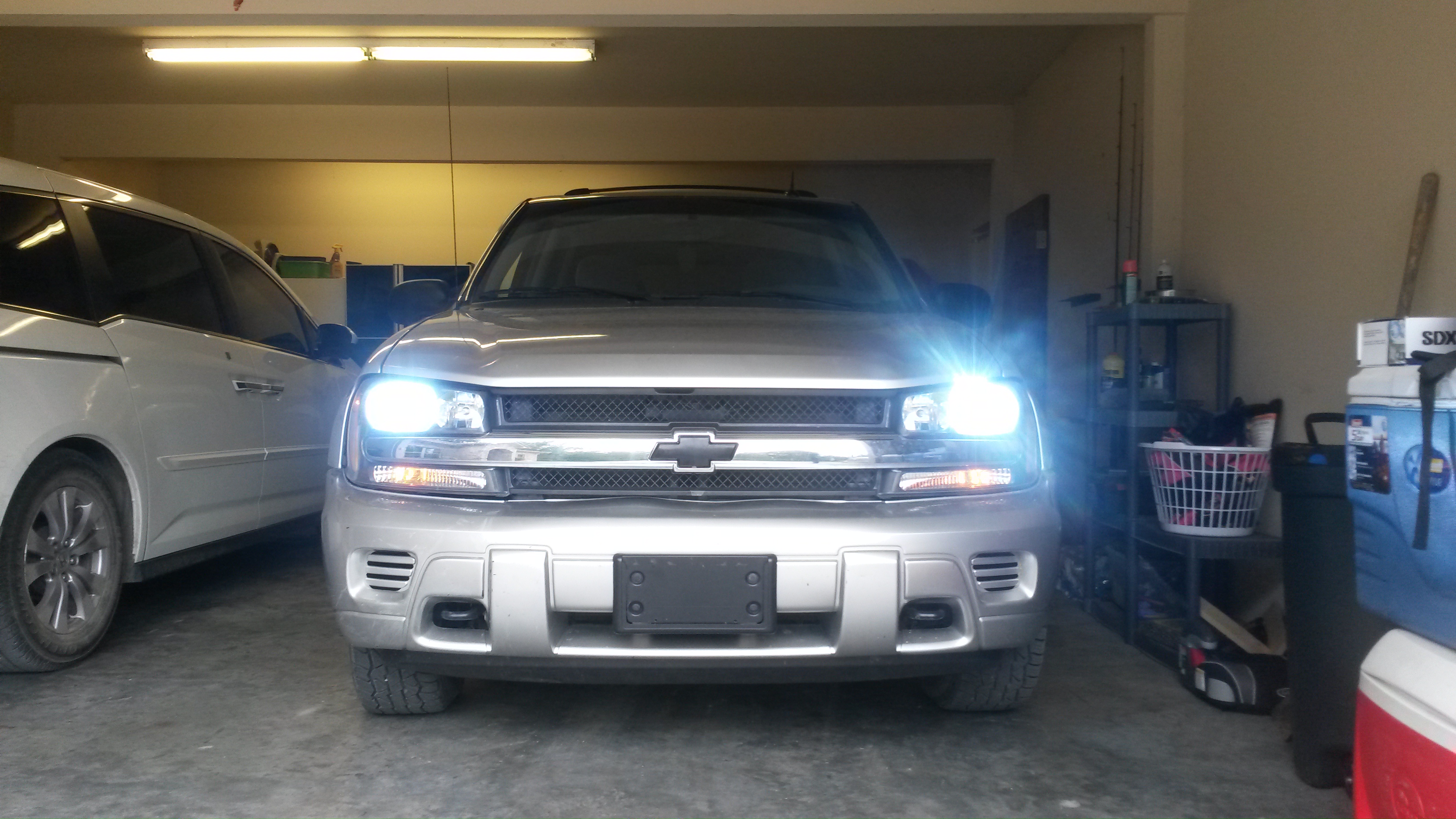

painted the bowtie and installed HIDs

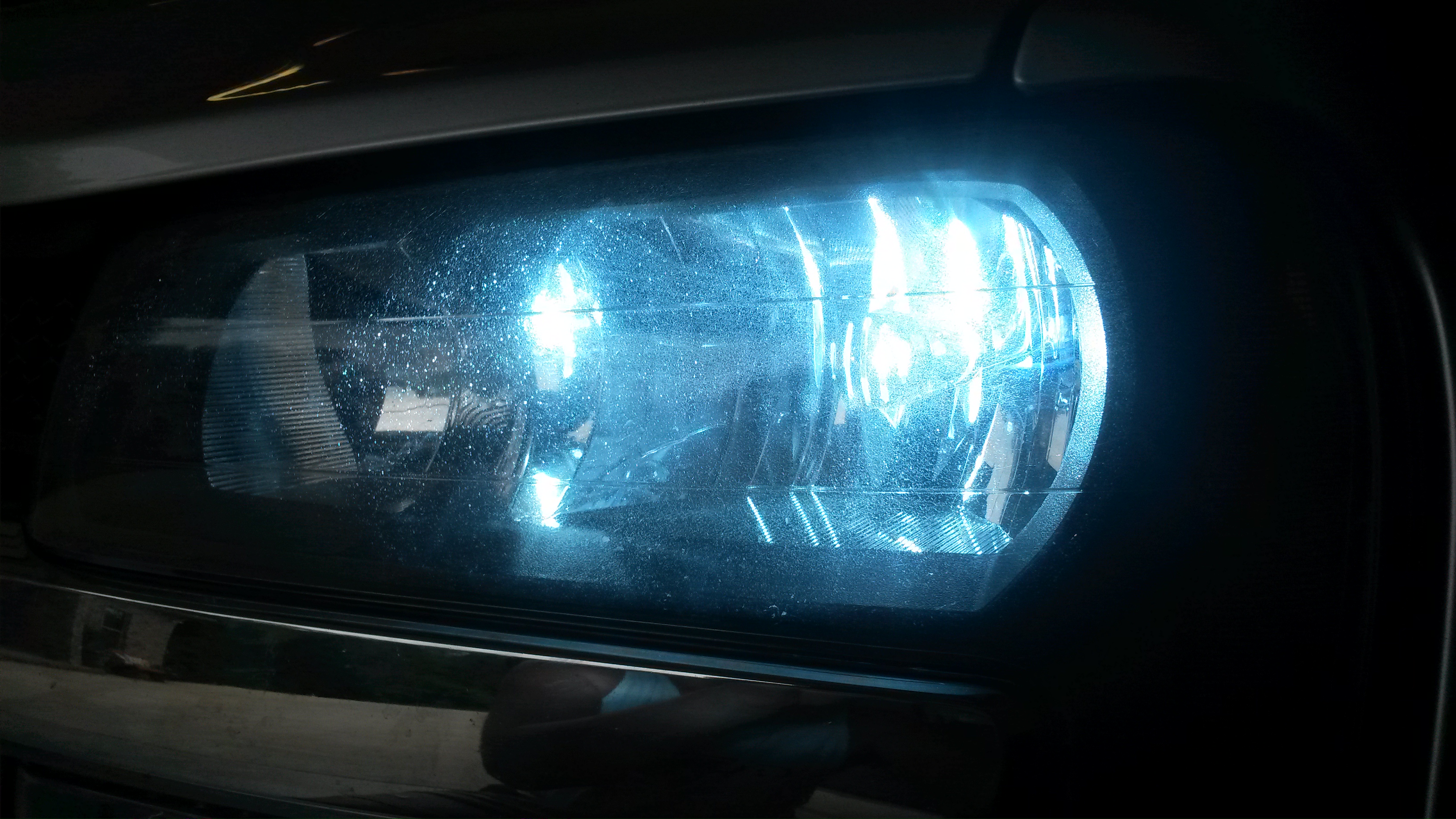

HIDs

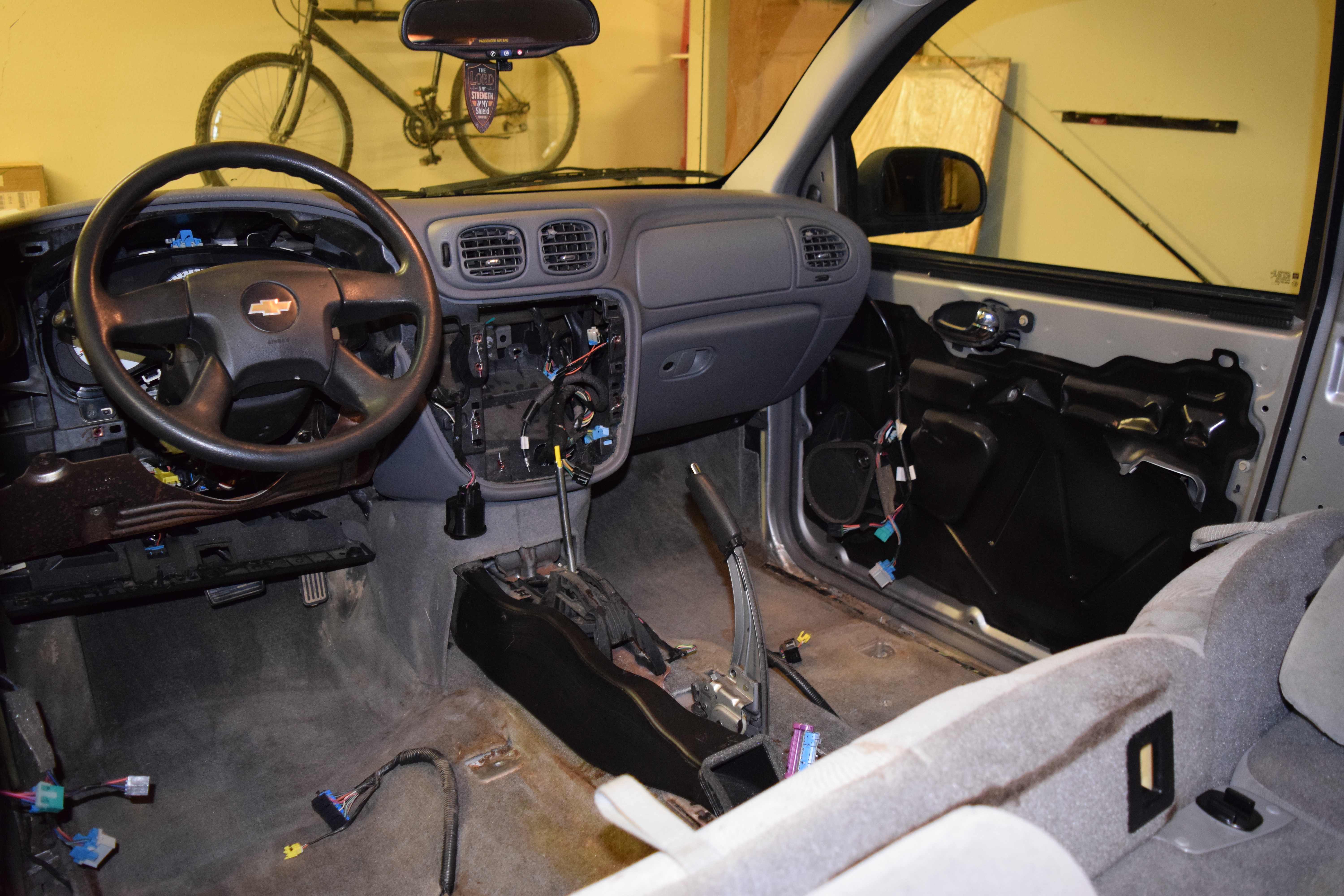

also did some major interior cleaning (whoever owned her before me wasn't very nice to her)

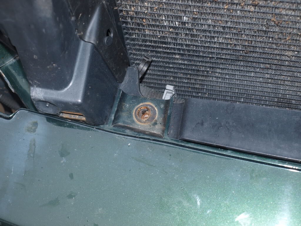

Don't toss the 20" led bar idea out just because your have nowhere to mount it . Think outside the box, lots of ideas in the build threads. However since you have a TB LS here is one easy solution. Get yourself some 1" square tube and flat stock say 1 1/2" - 2" wide and 1/8" thick. Heck you could use flat stock for everything.
If you remove your grill you will see these two bolts that hold the bumper cover on. You can use them to mount a bracket that you make with the above items. Just measure/cut as needed and bolt together and mount the bar. Very simple.

hmmmm... I never thought about those! taken the front end apart more times than I can remember and I know exactly what those are, just never thought about the mounting idea. man, I really need to start digging around in these threads more... thanks!!
