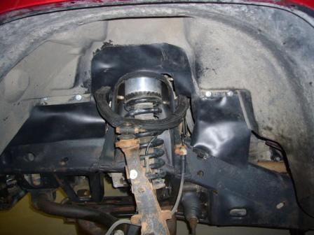

by Lauron » Fri Jul 18, 2014 9:06 am
bobfoe95, I share your concern about the gap if only a mater of keeping the engine from being packed with mud and debris. I retained the front fender liners to protect the electrical connection to the doors as well. For the gap I added the plastic liner cut from sheet material. This is what I had available and it is too thin. When I find thicker material, I will switch it out.

by bobfoe95 » Fri Jul 18, 2014 11:31 am
That plastic sheeting is a very good idea. I cannot tell from the pictures but how did you attach it to the frame, or is it only attached at the top?

by Lauron » Fri Jul 18, 2014 10:31 pm
The plastic sheeting is attached with U Type fasteners set on the inner fender sheet metal. You just need to drill holes in the sheet metal and slid the fasteners over the holes. I used fender washers on the screws to reduce tear out.
